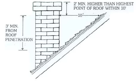

One thing I did notice is that the chimney on the outside of my house may not be high enough. It was built onto the existing exterior of the wall as an addition and does not go two feet above the roof line as measured from the peak. Rather it only goes about three feet above the roof line where it pokes up through the overhang and is about level with the peak of the roof.
The chimney height depends on the distance from the roof as well. In some cases it does not have to be higher than the peak of the roof.

Thank you for that. I think it may pass muster, as my roof slopes more genrty than the illustration above and the chimney is about 4 feet above the roof where it pokes through the overhang.
