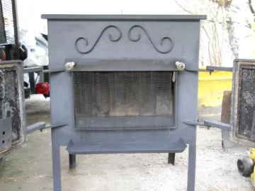

Quick question, have a relative with a Schrader stove, they bought the house and it was installed, they have been using it without issues.
Question is, what should be at the bottom of the stove. Do you burn on the base, should there be a grate, firebrick, etc.
Right now they are just burning wood on the bottom plate. Just want to make sure this is correct for the stove.
Are there firebricks on the side of the stove? Or any metal burn plates?
Double door fireplace uses bricks, I'd imagine they all do. Should have retainers around the top that brick slips up under. They fit across back first, then down each side. Last fill in the bottom to hold tight to sides. Leave about an inch of ash on the bottom as well.

Some of the early one i have seen have no bricks at all but later that have retainers for them on the sides and a layer on the bottom
I'd certainly add them if possible. After all, what kind of Fisher copy would it be without them. :mad:
