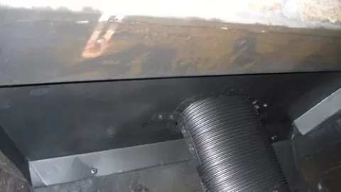

Hi,this is probably fine, (they know we are having an inspector) but I was taking photos of our install (today!) and this photo looked odd. We had been going from double walled stove pipe (for safety & clearances with cats) to a new flex liner in an existing chimney, but were told today that we could have the same price install for double wall stove pipe to piece of ovalized flex liner (to get it through our opening) to double walled stove pipe. We have heard that stove pipe was better for cleaning, so dh agreed. They installed a damper throat plate, and then attached the flex liner to the throat plate by screwing a bracket through the piece of flex liner (according to the photo.) Is this ok? I'm surprised you can just screw a support through the liner like this. :bug:

I'm not a code man, but I would think if they are allowed to do that down at the stove, it would be ok at the block off plate also. Those screws will be sealed with ash etc in no time anyways.
And kudos for them installing a block off plate.
As for the rest of the set up, I am not sure I understand what your explaining as far as the double wall and where it is in the set up?
