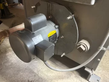

Tonight I will begin burning for the firewood heating season. The oil boiler has started to turn on too often for my liking.
The other day I installed a new fan motor, new fan ceramic heat shield, and fan assembly gasket. The original motor was still running, but was making some noise and it is time to do some maintenance work to it. The new motor is very quiet. A little more cleaning of inside of boiler tonight and I will slowly bring it up to temperature with some White Ash.

Motor probably just needs bearings. Fairly simple to do with a puller and can use a toaster oven to heat bearings up to get them on the shaft
Yup, a good motor will last through several sets of bearings, if taken care of otherwise, and not left go "too long" on the old bearings.
And yes to the toaster oven! I keep one on the shelf in the shop, just for bearings!
Also have an old electric stove/oven out there to heat up larger plastic parts, for customizing...PVC becomes very "cooperative" at about 220-240* ::-)

The old, original motor will now become the backup. I bought the new motor a few years ago, when I had some extra cash, and put it on the shelf in the boiler room. Replaced a few electrical parts in the original at that time and kept using it.
Used the small puller to get the fan off the shaft of the original motor.

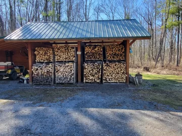

Time to move the cold season BTUs under some cover……

I had a problem with the new fan motor on my wood boiler earlier this week. I’ve been working and didn’t have much time to mess with it, but tried a few things. And then I thought of a small business not too far from my house that fixes motors and the like. I pulled the motor off, brought it to them yesterday, they fixed it in a few hours. Capacitor went bad. $89 total charge, with an extra capacitor to take with. I put it all back together and it’s humming along beautifully now. This is a big relief with the colder temps coming. I think I may have wired it wrong when I put the new one on, not sure. Strange thing is it ran for a month, then quit.
