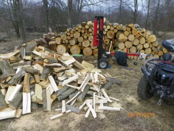

[Hearth.com] season before splitting?
Wood I get in the summer will sit in the round until winter. Everything splits easier frozen, something to do during the winter blah's, and burn of some of those holiday lb's. Plus no bugs or sun burns. Didn't work out the greatest this year as we had a good rain after the 1st snowfall, then the winter freeze hit. It was more work getting the round out of the ice than splitting it. But its all split waiting for the thaw to stack. If I stack now on the frozen ground, the stacks will surely fall at some point in the summer as the ground settles.
I will say this... On oak and maple I have split it splits a lot easier if I buck it and let it sit for a week. If I try to split as soon as I buck it, it seems much more difficult.
Just my experience.
