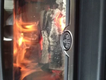

Merry Christmas , I have a question for you , how do you think these secondaries look after I used heat tape on about 25% of the hole on my primary air plate. I am seeing some white smoke at times out the chimney but that may be because of how cold it is. This is with the air pushed in about half way . The biggest difference I see is the wood is not engulfed in flames like it used to be . Stove top at 600 three splits in at 11am , will post how long this load last .
  • [Hearth.com] Secondaries after heat tape
That still looks robust. How far can you close off the air now? What happens now if it is closed off 75% or 100%?
Is it white smoke or steam? White smoke dissipates slowly, steam disappears quickly. When it is really cold you will see some steam even with wood that is less than 20%.
When I close the air all the way I get some small, lazy flames on the splits and some pretty robust secondary ignition.

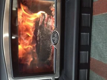

This is about 75% closed nothing coming from chimney, cruising at 600 sorry they are sideways
That looks better. Is these still lazy flame if the air is closed all the way?
Take the pictures with the cell phone vertical to avoid rotation issues.
With the air down all the way the flames / secondaries will get lazier or go out completely, two hrs in the three splits are reduced to coal logs and stove top is 450
That sounds about right. With a full, packed load I think you can cut down the air more aggressively and possibly all the way 20-30 min. into the burn. That should help extend burn times.
