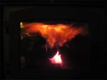

Forties outside and going down to thirties tonight so I decided to wake the 30-NCL from its summer slumber tonight. This secondary has been rolling for a little over an hour and a half burning that evil pine and isn't showing any signs of slowing down.

About the same here with the Jotul Oslo. It rolls and bubbles for a few hours and then the flames start to die down. I then start increasing the air (as temps start to drop) until about 200-250 reload, rechar and burn again.
