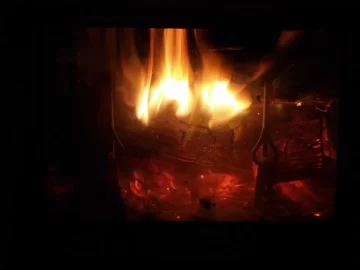

Thank you for sharing. I too do not, like the gold trim. That is why I asked. If it takes about an hour to get things cooking. Well then, I don't feel so bad. I am new to wood burning and thought an hour was excessive.
The pictures you posted. Are they in JPG format. I am unable to post JPG's as I get an error "The file you are attempting to upload has invalid content for its MIME type". They have been reduced to less than 300kb but still no good.
James
I think I figured it out. This is as pretty a flame I can get with the down draft. Certainly not as nice as the glowing fires of the burn tubes.

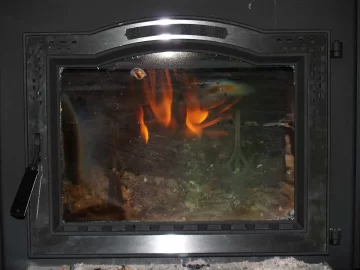

An hour up to temp and rolling for any wood stove isn't bad. There is a lot of mass to get up to temperature and the burning stages of wood to deal with. These things take some work but I have always thought it was worth it. I find it relaxing to not rush sometimes and just pull up a beverage and watch the pretty burn prior to the temp getting up to rock and roll territory.
I'll be sure to clean the glass next time I take any photos. Here is the same fire with no flash. It seems that the camera does not record the dancing blue flames. Or perhaps the exposures just missed them by a fraction of a second.
