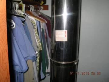

This heats our walk in closet.
Don't worry there is like 6 inches clearance to anything..label says you need 2", [Hearth.com] See what you think of this been like this since 86.
Code and mfg. says the pipe is to be in a chase. That exposed pipe is an accident waiting to happen.
