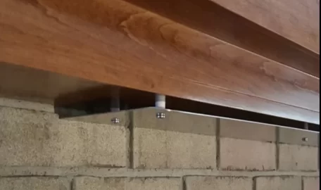

The Manchester may be the better solution. Will there be room enough for the side door to open for sideloading? It sounds like a mantel heat shield on the underside of the mantel could take care of the clearance issue.

I'm open to a heat shield, but don't want to mess up the look of the beautiful wood mantel. I saw this image on another thread, which looks decent but doesn't seem to be to code. Doesn't the shield need a 1" air gap?
