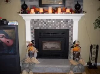

  • [Hearth.com] selecting a zero clearance fireplace
