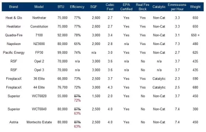

I've been researching EPA zero clearance fireplaces for quite some time. The one thing I don't like about the SBI line of ZC fireplaces is that they do not use real fire bricks. Instead they have 'refractory panels' which cosmetically try to look like bricks, but I'm not sure how well they retain and radiate heat. You can see the SBI FP's weigh considerably less than other fireplaces, which is also a concern to me.

?? I don't see any SBI fireplaces in that list, but yes they may be a bit lighter than some and heavier than others. They weigh a bit less than the RSF Opels. Refractory panels are used in some very high end stoves in Europe. They are very good at insulating the firebox and keeping the fire hotter which is their primary purpose.
Thanks for your list Matt.
SBI (REGENCY) makes - Drolet - Flame - Century Heating - Osburn - PSG - Enerzone - Valcourt.. I was looking at the Valcourt FP12 in my list, so that kinda puts that a bit to the side based on the firebrick issue.
I was leaning towards the Opel 2, but the firebrick issue with Valcourt and RSF make me question that a bit. Also, I hate thinking I will have to replace the cat five years down the line...

Perhaps adding a column to your list Matt listing retail price would help people in their decisions. Here is some info I picked up if you want to add it ...
Heat and Glo Northstar – $4600 – $300 coupon, optional screen
RSF Focus 320 - $3,500
RSF Opel 3 - $2329
Regency EX90 - $3300 - $300 rebate
Pacific Energy FP30 – $3500
Superior WRT4820 - $2879
Valcourt FP12 – $2850
Also, the Opels are EPA certified because they can only be sold in the US with a Cat and it meets the requirements. Apparently, in Canada you can get it without the Cat, and its except from EPA because of the burn rate but its still been certified by an independent lab to meet EPA standards with a rate of 2.8 grams/hour.
