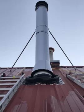

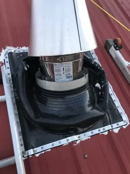

I know that some of the most experienced folks on this site strongly recommend against using rubber boot flashing kits for chimney installations. Fair enough. But for some of us, what’s done is done (and may have to be redone sooner than we’d like). In the meantime, this is a thread for addressing some problems associated with them.
For my own part, I recently installed a Selkirk rubber boot flashing kit with Selkirk class A chimney pipe and a Selkirk cathedral ceiling support box (all above a Drolet Escape 1800 and Vortex double wall stove pipe). One two occasions now, I’ve had water dripping from the cathedral ceiling support box. My suspicion is that snow is being blown up under the storm collar and down through the gap between the rubber boot flashing and the chimney. This gap is part of the design of the system to prevent the rubber from contacting the chimney.
I’ve seen other posts suggesting people use duct tape to cover the venting on ventilated metal flashing cones. Can this be done with the rubber boot kit? Would installing a longer storm collar help prevent snow from blowing in? Am I misdiagnosing the problem all together?
Any help would be greatly appreciated.

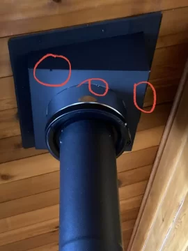

(Red circles in the photo indicate where the water is dripping)

That's an odd storm collar. I would expect one with a much broader skirt.

It looks like a normal storm collar could be installed right on top of the existing one without replacing it.

I did exactly the same thing using a selkirk boot that was supposed to accommodate up to 10/12 pitch (my roof). Well it sure as heck didn't and ended up as wrinkly as yours -or worse.
I couldn't have that mess, so I had a sheet metal shop make me a tin "roof jack" to cover the whole kit-and-kaboodle, leaving the rubber there and totally covered. That same storm collar you have goes above it. I suspect that you have a fold in the rubber going downhill right to the chimney or a place where water pools...It doesn't look like adequate silicone or even screws were used on the boot flange (I don't see any silicone squished out, and I used quite a few more screws than the kit provided -every one of them was put in, then taken out one by one with a tiny squirt of silicone in every hole so the screws could be re-installed in rubber). You could be right about the blowing snow, hard to say.

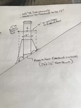

the drawing was my preliminary to the sheet metal guy for pricing. The photos were sent to the engineering department at Selkirk to illustrate that their boot could not accommodate a10/12 pitch. The sketch is still missing some info at this point.
I was going to remove the silicone overage, but that became moot.

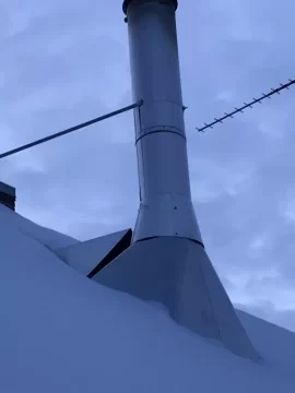

What's that white stuff on the roof? Thanks for the pic. I like the little triangle cap deflector in front of it.
Most of the higher end manufacturers have a snow diverter flashing available with a wedge on the top side
I figure that was for stopping a snow slide from putting pressure on the chimney. I have metal roofs on all of my buildings but generally don't have a snow slide problem. There's always the chance of a large snow here but not often any more, it's been years.
It's to divert the snow around the chimney if it slides so the chimney doesn't get ripped off
