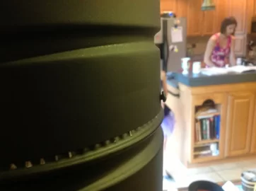

Here is a picture of a typical screw...

I don't know what that means?
This is fabulous. Picture of your wife calling her a typical screw.
You could have talked about the "loose screw" in that photo too.
Of course I know what you meant. That screw should suck in so that the head is against the outer wall. I'll add selkirk to my list of brands to avoid.
