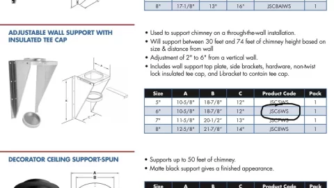

I’ve been searching all over the net for Selkirks adjustable wall support, specifically the one that is adjustable from 2-6” from the vertical wall. The part number is JSC6WS. I can’t seem to find any place that sells it.
Does anyone know if it has been discontinued or know where I can buy one?
[Hearth.com] Selkirk Wall Support
Might be an old catalog. For the Supervent JSC chimney, look for JSC6AWS. I think the Tee plug must be purchased separately, J61TPI

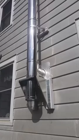

I was thinking of something similar to this. It looks like composite trim or something. Looks better than PT, and maybe I can find the right size. If I used PT I think I would use 4x4 and rip it to the 2 1/8” I need to clear the gable. Maybe I’m just being crazy.

Is that 2-1/8" including the 2" clearance to combustibles (overhanging shingles) that I think most class A pipes need?

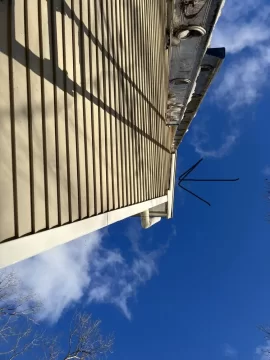

Yes, the wall bands and wall support have 2” clearance built into them. I just need an additional 2.125” to get around the roof line. I’ll add a picture to try to clear up what I’m talking about.
