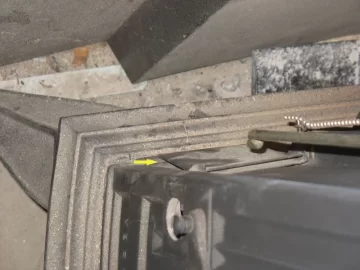

All of these things are accounted for in the stack-loss method of measuring overall efficiency. An array of sensors measure all of the gases that leave the flue, the volume of them, and the temperature at various points along the column. What you are suggesting simply does not occur in real life - in the lab, or in the stove at home.
You are using terms like "seems" instead of actually measuring the heat flow up and out of the stack. Just because you open the air up to an opening 4X as wide doesn't mean 4X as much heat is lost, all it really means is that there is less resistance to air flow at the intake. The stack is what determines the mass flow of the entire system. Once a good draft is well established, the intensity of the fire will actually increase as the intake opening is decreased. This is because the same amount of air is entering the stove, but at a higher velocity. Higher velocities cause turbulent air flow, and turbulence is the best and most efficient gas/air mixer there is. If you can burn it all here in the primary fire zone, there will be nothing left for the secondary air to combine with. This doesn't happen, but you can get close with proper stove design and good air control practices.
Here is a photo of the air intake of my stove taken while burning a load of very green wood last year. The stove was at 750º, the flue was at 600º, and the basement was about 85º. As you can see, the air is shut down pretty far, about 1/8 or so of the max opening. I had shut the draft down in increments, just like I would do with dry wood. I do this by ear, not by the numbers. It was probably open more than I might leave it with dry wood, but not by a bunch. Once I got the burn well established, the stove was handling that wet load just fine and was producing massive amounts of heat in the living space where I want it. A bit too much heat, in fact, but I was doing it to prove a point to myself, so I pushed it as far as I could.
BTW, that particular load lasted a very long time, and burned smoke-free even when I closed the bypass and sent the thing into a nice secondary combustion. The reason why is that I initially got the stove very hot and kept it that way throughout the burn by regulating the air rather than just opening it all the way.
