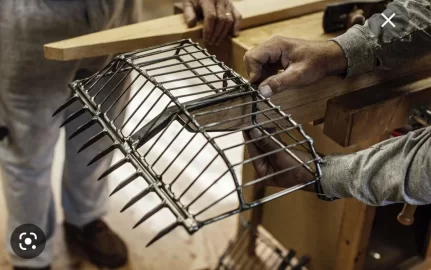

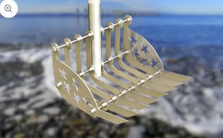

I keep running across threads about separating coals. Sound like I need to invent a modified clam rake with the handle orientation adjusted 90*. Push to the back of the box, give a slight jiggle and dump the coals in a pile or hold them elevated and remove a little ash if needed.
The first one you could unbolt the fingers and put the handle on the other front spacer rod then the back rear spacer rod.

The second one is closer, just a little too steep on the teeth.

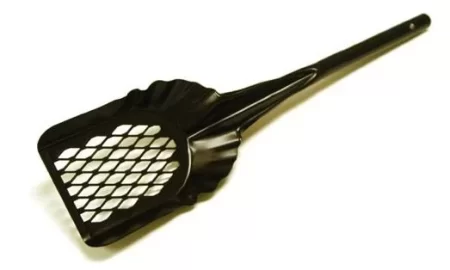

I use this.
It's as light as you can get while being non-combustible. The holes are big enough to not have ash hang in there.

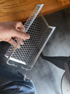

Was at lowes a bit ago and walked past some paint roller grates. I thought, hmmmm?? $4, What the heck.
[Hearth.com] Separating ash & coal in shallow firebox
Tough to film and do one handed. I’m not amphibious.

Thank You for the idea.....ive been looking for metal screen with the right size holes.....we are going o Lowes in the morning....its wort a shot for a few bucks, thanks for posting with photos.
