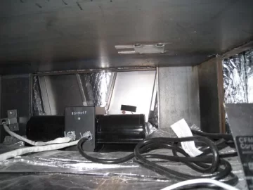

Hi - I purchased this unit and had a local contractor install it. I just used it for the first time and have a few issues with it. I am hoping someone on this forum has some experience with it.
1) blower installation - the manual really does not say how to install it. It looks like there is a piece missing that should connect the blower to the firebox air manfiolds that surround the firebox and carry the heated air to the top vents. But I have no such a piece. I am attaching a photo of the underside of the firebox where the blower is currently.

If I'm looking at that picture correctly, you have the blower pointing the wrong way. Those rectangular blower outlets should point up into those two vertical air channels. Flip it end-for-end and put the face that's currently on the floor up against the back wall.

Thx for the reply. I will try that (this weekend since its a vacation house). But it does not look like the blower face will cover/seal off the air-channels intake completely, so some of the air that is blown will not make it into the channel. Wasted blowing air. Shoudn't there be some cover plate so that all the air coming out of the blower goes through the air channel? -Yurij
It seems like it, but my Majestic doesn't have such a plate and most of the air still makes it up and out the top louvres. But the way it is currently it's all going to blow right out the bottom louvres.

DiscoInferno - I tried to move the fan, but the wire to the temperature sensor is just short to place the fan up against the air vent. my sensor is on the left (you can jsut see it in the picture). But, i could not get the fan to go on. I had power to the wire (the fan is pluugged into an outlet and the outlet has power. I turned the speed on control to various positions (all the way produces an audible click which i assume is off), but no fan. the fire i had in the unit was on the low side, but still. when does the temperature sensor kick in? thx -yurij
The on temp depends on the sensor, but with that sensor placement (effectively on the "leg" of the stove) it might take quite a while to get warm enough. On my Ultima I have the sensor mounted on the side of the box near the bottom, and it still can take 30-45 minutes of hard burning for the blower to kick in. Unfortunately it looks to be attached with screws, rather than a magnet. You could solve both problems by moving the sensor to the bottom of the stove just above the blower, but I'd be hesitant to drill holes there. Perhaps glue on a couple magnets instead.

Resolution: the dealers technical guy came by and fixed it all.
1) blower just lays up against that manifold and is held by velcro. go figure.
2) the installer (not the dealer), put the temperature sensor in the wrong place. it should be attached to the underneath of the firebox.
3) the very stiff primary air control needed some "lubricant". high temperature, but now it works like a charm.
