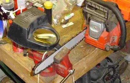

I've included a picture of how I sharpen my chains. I've been doing this for about 4 years now doing about 10+ chains per year. I tried every conceivable gadget to hold, brace, angle and everything else to the chain while I hand sharpened which resulted in reasonable sharpness. I then read about the dremel and have tossed all the other stuff in the recycle bins - long gone. What I do is put the chainsaw in the vice and then position the magnifying glass above the chain. I then eyeball the dremel on to each chain segment and grind. I keep the angle of the dremel aligned with the link and lightly grind. When I see the top of the link start to sharpen I go on to the next. I get a chain done in about 6-8 minutes taking my time. In addition to being quick and easy these chains cut as good as a new chain and, yes, I am patting myself on the back.... The chains seem to last long.
I use this method to cut about 5 cord per year which meets my needs.
Now go easy on the critique.....
