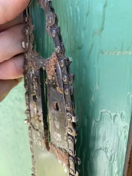

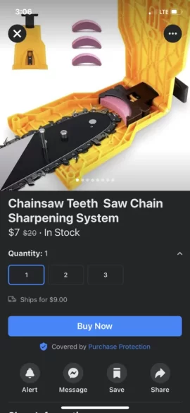

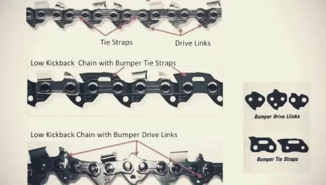

I’m starting to cut more wood than I used to (in preparation for a fireplace insert purchase soon) so I definitely need to figure out how to sharpen my chainsaw chain. Based on some comments here, and on my relative lack of experience doing this, it seems like a Stihl 2-in-1 sharpener (or the similar Pferd) could be a good bet, making it somewhat easier to get the correct angle than using a handheld file.
But if I get this, I want to be sure to get the right one. I have an EGO 16” saw, and the chain specs say “043 in. Gauge Chain with 3/8 in. Low Pro Pitch”. Looking at the Stihl sharpeners, there is one for 3/8 inch pitch chains, and one for their 3/8 inch pitch Picco chains. I assume just the regular 3/8 inch one would be ok for other brands of 3/8 inch pitch chains, and that I don’t need to worry about the gauge? Is that correct?
Thanks for any thoughts on this, or recommendations for other sharpeners.
