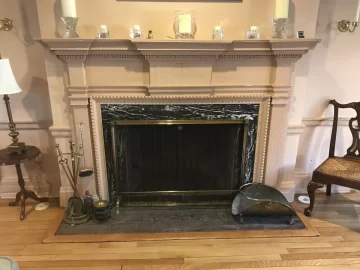

Are you going for a period look or is supplemental heat the priority? Is this fireplace are in a closed off room or part of an open floorplan?
An important issue will be mantel clearances. That can be addressed by replacing the mantel or sticking with a flush insert, though the fireplace depth may be a blocking factor. Given that fit is critical, it would help to fill in this diagram with dimensions.
A= 30”
B= 10” all the way at the back
C = (something greater than 28”)
D= 28”
E=
This depends on the height at which you take the measurement:
0” high: 24.5”
12” high: 24”
16” high: 22”
20” high: 19.5”
22” high: 18”
24” high: 17”
30” high: 11”
F= 14.5”
G=78”
H= 50”
I=37”
J=37-56 as you can see wood immediately above marble

For a period look, the Hampton Hi2450 looks like it will just fit. In catalytic inserts there is the Blaze King Ashford insert. Mantel clearances will need to be taken into account but need not be a showstopper.
I think of you could extend that hearth a Woodstock Fireview would look really nice there.

Do you think the smoke shelf would need to be ripped out? 4+“ of clearance for some curved fitting?
Woodstock Fireview is the prettiest of what’s been proposed here IMO.
It's a good medium-sized stove with a long track record.
That's not a big deal. It's pretty typical to have to notch that area to clear the liner.
You can drive up to New Lebanon NH and see them. They sell direct to consumer as well. I personally know the staff there and they are very, very helpful. Then all you need is a CSIA or NFI or NCSG certified installer. Chimney sweeps are often available to tackle your type of installation.

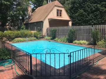

I will also be able to get to the top of that chimney to drop a liner down on my own. I’d love to have some method to add a heat exchanger to maybe heat this pool too. Dare to dream. I’ve piped natural gas into the garage and have considered the concept of buying an identical modcon boiler for the garage as whatever I get for the house. The benefits would be spare parts for a house modcon (because there’s always fear of it taking several days to get parts for them), and having a boiler WAY oversized for the garage but capable of possibly being used as a pool heater. Heating with wood and yard waste should be a greener approach though. Heating a pool here is probably a real waste.

Skip the pool. Easier to just pick up a cheap heat pump for that, under $5k and fully automatic. Don't worry about the mantel or the piano, neither have a direct line of sight to the fire, and neither will get hot enough to matter. I have two large harps and a baby grand near one of my wood stoves, and an orchestra of stringed instruments near the other, no issues as long as they're not sitting directly in front of the radiant surface that is the front glass. I also have large framed surrounds and even doors, on each of my fireplaces, with no issues.
