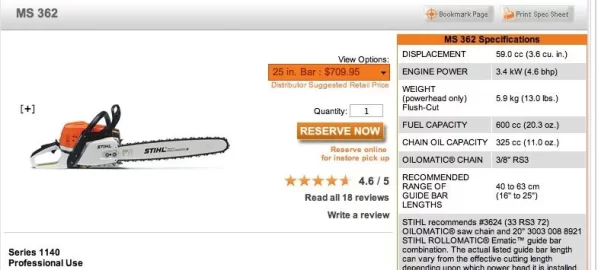

Sure is a pretty saw but $739.95 gets you a new one from a dealer. ;)
(Edited that price once I saw it's the "R" model.)
Maybe if he comes down to $600 I'd bite.

I'd bite at $550.
Nice looking saw for sure but seems pricy considering the cost of a new, off the shelf one from a dealer. My price point is always based on how I "feel" - am I happy with the deal regardless or will I have buyers remorse. No doubt you will find a slighlty better deal if you look hard enough right after a purchase but if you are happy, you are happy.

If I were to spend that much. I'd really consider just buying it new ;)
Get the warranty & get to know the local dealer. May throw in a new chain or 2 ;)
