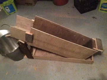

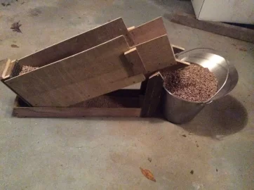

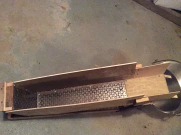

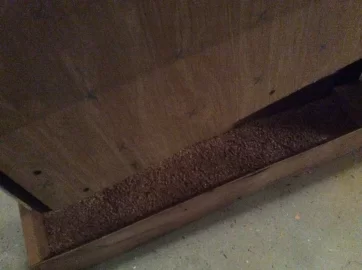

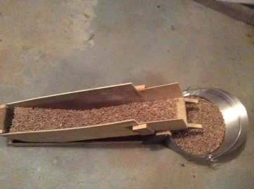

Here is my Rube Goldberg pellet shaker, in pour in 1/3 bag at a time and shake then dump. Repeat....
Made from scrap luan plywood, expanded metal and some old pieces of 1x3
