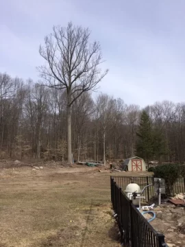

I have one huge poplar tree on my property. it's beautiful, but I think it is getting too big. Knowing that poplar is fast growing tree and prone to fall makes me thinking. I put 8 ' stepladder next to the tree for reference in a picture. If its going to fall now, it's not goanna reach pool or pond nearby, but give it 6 more feet and its going to hit it. The shed is right next to it. I have a crew that will shred some brush coming next week, should I take this tree down and make them clean it while they are at the site? It's going to cost much more getting them just for that tree in a future.
Here is the pics

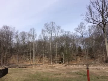

I know I'm kinda answering my own question. It's just that I got another 5 beautiful beech trees to process ( you can see it in a second picture). And now all this work for a poplar. Wish it was oak.

From the picture it looks too far away to hit the pool anytime soon.
As for the shed doesn't matter. It's an easy drop and someone would really have to screw up not to put it down so that it avoids the shed.
Personally if you want the wood now its an easy drop.
The tree itself looks healthy, I've got a few poplars about that size and mine seem fine . Are they signs of rot and decay around the tree trunk ? Are there mushrooms growing around it ? If it's solid the tree should be fine.
Are you dropping it yourself ? I'd shoot a string line up to that first leader off the right with a slingshot and bean bag. Id tie my rope onto the string pull it through so I can run a running bowline knot up to the crotch. Id use my 4way pully and a couple neighbors on the rope and just put the tree on the ground. 15 minutes or less. Perhaps you don't need a rope even. Looks like you probably don't in the photo
If you want the firewood do it now. Or you can let it wait for a long time if you want. I don't see any red flags in that picture at all that says you need to drop that tree anytime soon. Unless you want it on the ground
I'd keep that tree. It is a beauty. Tulip Poplar can get really tall and I don't think they are more prone to blowing down than most other trees. The soil is the biggest factor in whether trees will be toppled by wind. Are there a lot of other wind thrown trees in the area? Trees that toppled and pulled a root ball of soil out of the ground? If not I wouldn't worry at all, and in any case I don't see much that the tree could hit besides a shed. Yes, it would be a drag to have it hit the shed but that seems like a long shot.

The bigger the canopy, the more surface area for the wind to hit.....that would be really the only reason (and soil) I could think of why it would be more prone to blow over. That tree really stands out and above the rest. I'm taking down much smaller ones (8-12" dia) on the back wooded part of my property, only because there are so many of them, choking out the oaks and smaller ash trees.....probably cut 30 already with 20 more to go. I do notice firewood from the bigger trees is better than the smaller ones. I wouldn't mess with it.
They are one of my most common trees and I can't say that I have ever seen a healthy one fall over. Even the dead ones start dropping from the top first. I would not cut that tree.
Shame to take down a big tree like that if it's healthy. If anything I might consider some pruning to lessen the amount of wind it catches and to keep it looking good.

Personally I'd suggest leaving it stand unless it's showing signs of imminent demise.
Forest poplars, which yours appears to be aren't prone to blowing over any more than most other tree species. What kills 'em is base or root damage, often from excavations or logging equipment used near the tree.
