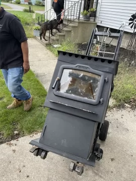

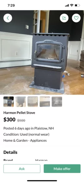

Hi
What do you think of this Harman P61 in very good condition I just picked up for $300.00
[Hearth.com] should I upgrade my stove [Hearth.com] should I upgrade my stove
Nice find Don, complete refinish? I don’t think I’ve ever seen a completely bare P61…
Not refinished but kept up very well. The lady said a guy called right after me and said if I did not show up, then he would come get it right away! So it was a lucky day! :cool:
