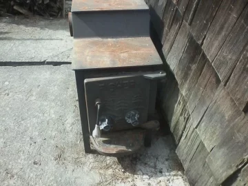

My dad recently passed and we are converting the house to rent rooms, although I will still live here. The stove hasn't been used in a decade or two (nor has the chimney been swept) but there is some nostalgic value, as it was our only source of heat growing up and my mom built tiny formica-covered stools for each of us kids to sit on, while we ate breakfast in our Star Wars-inspired "jawas" we'd wore to sleep.
Anyway, we sort of need the space where it sits for a second refrigerator, so my question is, is there any value to these things other than nostalgia? How hard is it to find an wood burning stove these days? Can you even buy them, or do they have to be expensive clean-burning varieties?
Basically, would you keep it or sell it, and if the latter, what might be a fair price?

I love these little stoves but I am not sure I would purchase one with a weld repair on the door. I kinda see these stoves (for me) as something I'd place in a shop or cabin and they add to the nostalgia. There are too many out there with no weld repairs too even consider one that has issues. So in that regard I would think it would not be too valuable, maybe a hundred bucks. Please do not be offended, just trying to be honest as I'd want someone being with me.

Definitely a first year 1974 stove.
Any markings on the bottom like writing in weld?? FSSO with initials of welder would be the original shop in Springfield. That would make it a keeper or drive up the price for a collector. The fabricator in Seattle was Bob's cousin Barb and her husband Frank Jorgenson. Not sure if they used any of the old style doors since a few cracked between air intakes and was the reason for the new thicker doors with Fir Trees for strength. The new doors with trees was months before they bought their license for the Seattle area.

If that door cracked before 1988 they could have taken it back for a new one or had it replaced with the new style.
It's a shame too since it's a Lefty! Yours is a Papa, but Mama uses the same door. I would be searching scrap yards and pull a door from one if possible. To the right person, you have something quite rare. Looks like it was brazed, which is much softer than weld, so it could probably be ground off on the front and repaired inside. You're still going to notice it on the outside, I would still make it as good as I could and keep it. But that is from a collector on the East Coast where we didn't have any that old here. There were not many patterns for doors back then, so there is a very good chance another left hand Springfield door you find will fit the hinge plates as installed on the stove. As time went on there were many foundries making doors, with slightly different patterns (molds) so each stove had hinge plates welded in position for the exact door being installed. So newer stoves need the hinge plates repositioned for another door.
*** It can only be used as connected (grandfathered) as it is, in your state. Also not sold legally in operable condition. Only EPA certified stoves are legal when installed as a new installation now. If the building is sold, it must also be removed. With all the rebates and programs to replace old stoves these are rare in the small market where they were made. Laws also state non-EPA stoves must be decommissioned by welding outlet shut so they can't be reused elsewhere. You will still find many being sold in all 3 states with these laws near you.***

I would scrap it in a heartbeat the damage to the door in my mind destroys any value it had.
Sad to hear so late that Fisher would've replaced the door for us. It broke in '82 or '83 and my 14 year old brother repaired it in his high school metal shop class.
No special markings underneath, though consensus here is that it is certainly an early model. Judging the year by my dad's hair styles, 1974 seems about right.
It may stay put for awhile yet, since moving a 500lb bulky object is no simple task, but given the legal (and environmental) issues the plan is probably to scrap it. We could post it on Craigslist with a strong disclaimer, but then who would buy something for $100 if they can't use it and can only scrap it for 2 cents a pound?
