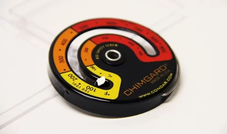

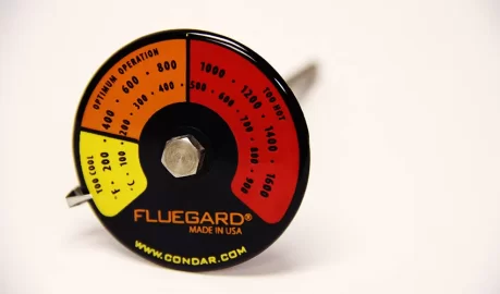

Here is the guidance. Clear as day. Don't fall into the too cool zone. Probe for double wall and surface for single wall. If you have an IR gun, refer to the surface meter temperature zones.
Worth noting that these meters have been modernized to reflect slightly lower "safe" temperatures than the older versions. Maybe to reflect cleaner burning equipment, or higher efficiencies, or just experience.

Not at all. Temps read at the stove pipe, probe or surface, are not the same as what happens later in chimney as flue gas temps cool down. One is trying to compensate for the cooling of flue gases as they reach the exterior portions of the chimney. How much one compensates will depend on the installation.
Chimney insulation is much more robust so surface temps there mean little. One could have 500º flue gases and only read 100º skin temp on an outdoor chimney pipe. Thus chimney pipe skin temps don't mean much. And what if it is a masonry chimney? Maybe I am missing something but this is the first time I have heard that suggested. Neither a surface or a probe thermometer is used on an exterior chimney.
A 250º surface temp = ~ 500º flue gas temp in the stove pipe. It is unlikely that there will be a 250º temperature drop at the top of a shorter, well insulated, interior flue system when it is 45º outside. When in doubt, go by how the chimney top section looks. On inspection of cleaning, if it is mostly a thin layer of soot then there isn't evidence of creosote accumulation. If it is thick with black sote then try burning with a bit hotter flue temps. If it is tarry or glassy solids then burn drier wood and at hotter flue temps.
