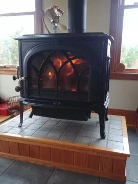

A lot of people ask how to keep a stove from overheating the house with a non-cat stove in milder weather. This will depend on the stove, but the basics start with less fuel. Here's what I did this morning.
With a morning temperature of 44ºF at 7am I was on the fence about starting a fire. It's a sunny day and I knew that temps will be rising and the sun will be warming the house in a few hours. Interior temp was still at 65º sleep setting on the heat pump. I had some gnarly pieces of wood that I wanted to burn up so I decided to start a fire. The question is how large. If I filled the T6 the house would be up to 80+ by noontime. Instead I loaded 6 medium-sized (3-4") splits N/S with a decent gap between them to fit some newspaper balls and a little kindling. The wood is wild cherry. 6 medium splits is about 1/3d the capacity of the firebox. The fire caught quickly and by 300º probe flue temp I was able to reduce the air by 50%. Stove top temp at that time was around 190º. I let the fire regain strength and in about 7 more minutes the flue temp had risen to 375º, stovetop temp was approaching 300º. With secondary combustion started I set the air to 75% closed and left the stove to do it's thing for the rest of the morning. The fire will burn out to ashes at some point in the afternoon.

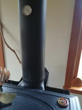

At 10:30am the outside temp had risen to 51º, indoor temp is at 69º and sun is streaming now through the windows. The stovetop temp is 430º, flue temp is 300º and the fire is in the coaling stage. As outdoor temps in crease the stove temp will decline. This keeps the house at a comfortable temperature with a clean burning morning fire.
At 1pm there still are large glowing chunks toward the back of the stove. The stove top is 270º and flue temp is 200º. Outside temp is 54º, indoor temp is 71º. Perfect. Time to get out and mow the lawn.
How long does it usually take you to reach 300 probe temp? I don’t have an auber thermometer on my liner so I can only guess.
It varies with the wood and how I load it. Hardwood starts a little slower. Doug fir can take off quickly. Usually it's 10-15 minutes but has been in as little as 7 minutes with dry doug fir if there are some smaller pieces in there.

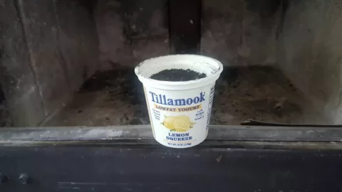

Yikes, I refuse to run a stove with flue PROBE temperatures that low. At 300 you are well into the too cold range on the meter creating tar creosote. 300 internal means approximately 150 surface temp which is way below the condensation point in the chimney. I burn much longer than most folks into the warm season but you have to do it responsibly and safely.

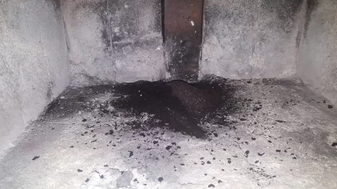

Read again. The air was closed down to 75% at 375º and climbing. The flue temp eventually peaked around 470º. As I said, it was a small fire and the 300º flue temp was at the coaling stage. Creosote is a non-issue then. Nothing irresponsible was posted, we've been getting less than a cup of creosote with annual cleanings.
I worry that even peaking at 475 is too cool since that is still dangerously close to condensation temperatures and is the hottest part of the chimney. Sounds like a recipe for a gooey tar mess.
The shoulder seasons encourage such behaviors and that’s why it’s even more important to burn short, hot, fires to minimize creosote buildup.
If you can’t run hot enough to get the flue safely above condensation temperatures then perhaps you’re better off running your furnace.
You worry too much. This is an insulated straight up chimney on a non-cat stove. No gooey tar mess has shown up in years. All we get is some brown powder and a little black soot. The only time I had creosote buildup in the past 24 years was several years ago when I started off the season with a load of maple that had gotten wet under the tarps. Now all the wood we burn does its final seasoning in the shed.

This is after about 2.5 cords burned.
