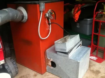

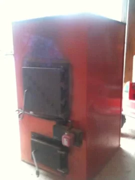

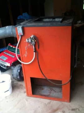

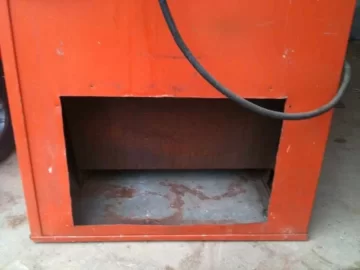

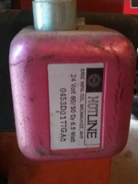

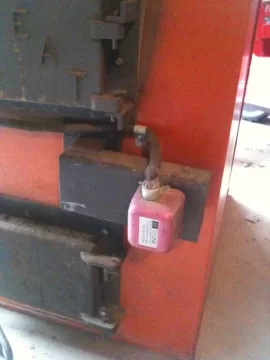

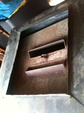

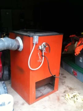

Here are the pics. There are quite a few.
  • [Hearth.com] Shurheat Wood Furnace
Last one.
The furnace has a limit control for the fan and the automatic damper in the front of the door. I'm thinking more than likely it had a blower inside the sheetmetal box in the last picture. All the safety features are there if they operate properly. I don't see a tag on the unit so you should contact your insurance company before I would attempt to install it. It doesn't look bad for its age, which its an older furnace. Look inside for warping, cracks, etc. That will tell you if its been abused or overfired.
