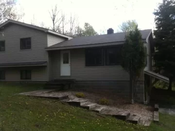

Ok, my house has a staggered 4 story plan. The chimney for the Wells-McLain Fuel Oil Furnace and Bock Fuel Oil water heater runs pretty much thru the center of the home. If you enter on the side door you will be entering the basement, this is where fuel oil furnace, water heater, fuel oil tank, washer/dryer, mudd room, deep freezer, cold storage, and Bowtech Bow reside.
You then walk up 6 stairs and you will be entering the family room area, here you will find a bathroom, cozyheat fireplace, this space is open 100% with exception of the bathroom. There is also a 10 pound Walleye above the mantle. 5 large windows and material is mainly barnwood on lower walls with barnwood covered steel support beams.

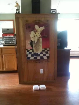

Ok, now go up 6 more stairs, you are now directly over the basement. This is the common area, kitchen and small living room for guest. This is also where the main entrance to the house is. If you notice in the pics there is a giant fat cook man picture, that covered box directly behind him is the chimney. If you notice on the floor I have 2 white boxes, this is where I wanted to put a grate in and run duct from the Hotblast in the basement. These 2 white boxes sit straight above the Hotblast Stove.
Ok, now go up 6 more stairs. You are now right above the 2nd floor family area. This floor has the master bedroom, 2 kids rooms, and bathroom. In the master bedroom closet there is a what appears to be a stainless pipe for the chimney, seems to be 24". It is kinda weird, it is not the brick chimney that I grew up seeing. It is literally a pipe running thru the house.
Thanks for listening, I await your advice.

Sorry, I'm in the middle of a remodel on our nursery so I am busy. Heres a couple pics that show the house and the furnace. Its a 1300 hotblast, the smaller of the hotblast models. From what I have seen you have baseboard heat. To really get the benefits of a furnace you should have it ducted. Otherwise if it sits in one room and heats the house, then maybe a stove would do the same thing while burning less wood. Having a multi-level home it may not heat evenly if the woodfurnace isn't ducted. With a woodfurnace like that and where you live I would have at least 6 cords, but I wouldn't doubt if you use more. Looking at the home and the age, if its well sealed that shureheat would be too much. I would follow begreens advice and get rid of the furnace. Your hotblast 1300 looks like its been used very little. We heated our 2400 sqft home with a furnace like the hotblast for over 20 years before retiring it and going with something thats more efficient.

If you look at the photo of the hot blast, the two holes on top are directly below the 2 white boxes on the floor above. I was going to run one duct pipe straight up and have a grate. I think once I get heat on that level it will rise to the top staggered level. I talked to the builder who lives a few houses down and he said he built that house and designed it for efficently burning and heating with wood.
