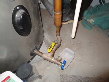

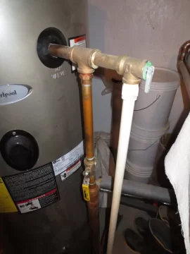

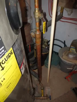

Does anyone know of a bladder or plug I could temp install in isolate the sidearm from my hotwater tank? What I'm thinking is if I could insert a plug into the 3/4" pipe say between the tank and my sidearm after I remove the PT valve I could then force air down my side arm and see if there was a blockage there. I thought I've seen bladders that are used for testing pvc pipe but bigger diameters used on the waste side of the system. Really trying to avoid tearing the whole thing apart.
Here's a few pics of how my sidearm is plumbed in.
Is there such a thing as a 3/4" copper 'Y'? I was thinking if I cut a Y into above the sidearm and below the T (which feeds the PT valve) I could plug it and when I needed I could use it like a clean out to ram something down inside so the scale would fall to the bottom and get flushed out. Part of my issue is I don't have any shut off between the tank and the T's so I can't force water or air thur the sidearm, which might help to clean it out.

I think it's time to cut it right out to check it out & clean it, & plumb it back in with some more valves & boiler drains for future flushing. It shouldn't be that bad a job (relatively speaking) with a couple of unions or couplings.

I thinking about putting a cross into my system ( (broken link removed) ) directly above my sidearm with a plug on the top, going to the right will be my PT valve and to the left will the the water tank. My thinking is this way I can take the plug out and run some sort of snake or small metal rod down thru the inside of the sidearm and clear out the lime and then when I open the drain valve at the bottom that will flush out the junk.
