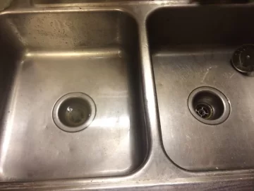

Any plumbers out there. I have gone through 10 years of this and I think I have had enough..
In my 2 bay sink, the one on the left does not drain unless I plunge it and plunge it and plunge it. Then if I fill it back up with water, it usually does not drain again. but yet the other side drains fine and fast.
any ideas?

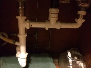

Something might be caught in the pipe - have you pulled it apart to check? There's really not much there to go wrong. If the water from the left sink doesn't rise up into the right sink, the blockage is not below the first tee. It looks like there's a lot of silicone outside the left pipes - looks like a homeowner's mess - there might be some silicone blocking the pipe.

I have seen strange things happen when pipes are inadequate vented. In theory if the pipe is far away from the main stack it has to have an independent riser that goes up to the vent. This riser is usually hidden in the wall

Might want to take it apart underneath and check out the T fitting which joins the two sinks. There should be similar baffles in that T on each side to prevent the water draining from one sink from going over into the other. It may be that that T is not the proper one for your double sink or that there is some obstruction on the left side. The two nuts on each side of the T should be the same, which leads me to suspect that fitting is one which is usually used in a vertical configuration.
If you're not sure when you look at it, just reverse the T (spin it 180) so that the left side is on the right and see if the problem doesn't end up with the right sink.

If the right sink drains good, but the left is so bad it needs plunging, it would seem to me that the problem must be somewhere between the trap and the left sink hole. If there is a problem further downstream, it would have to affect the right one too. Did you take the T right off too?
BTW, I think your dishwasher hookup isn't right either - it should be above the trap or else you will get sewer gasses backing up into your dishes. Eeww.
X2

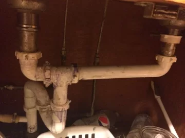

looks like left side is too low @ elbow. water fills entire pipe and has no air to drain. shorting slip from left sink move drain to center and pitch both left and right to drain. equal runs and equal slope.
X1 that's one problem. the dishwasher should have it's own trap. the drain comes out of the pump then goes up the side then down and thru the cabinet to the drain pipe. all dishwashers have this. if not someone unhooked it. if the drain from the sink went into the wall i would say ok that is it's vent. but it goes down to the basement if it has a vent down there it's not a very good one.
Yeah that's another reason to take apart the piping under the sink and troubleshoot the problem. In any case swap out that dishwasher tailpipe with the one under the left sink above the trap -- the dw should drain above the trap.
I'd try just hooking up the left sink by itself to the drain and see if there still is a problem. If so maybe try one of those cheater vents mentioned before, to see if that fixes it. If there is no problem then it might be that tee fitting.

also if you are going to pull apart the piping try replacing the tee with two ty fittings. the ty works much better.
I thought that was camera perspective I was looking at.
The more I look the more I'm not sure.
-You have an S trap which is not legal
-I don't see a vent
-The dishwasher should be above the trap or have its own
The lack of vent is probably causing the slow draining, once you fix the vent problem though the S trap is going to suction all of the water out of the trap and you are going to get sewer gas out of your sink drains. If you do replace it consider using normal 2" PVC (glue together) and some rubber couplings, those screw together sink kits seem almost guaranteed to leak.
Unless you have a vent that goes up the wall behind the sink or use an air admittance valve:

It is slightly lower on the left side. The metal pipe coming off the sink is longer.

So I should have something like this for the dishwasher drain..

Ok. Well here is what I did tonight. So far so good. I filled both sinks up several times to test and they both drained fast.
