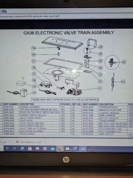

Fireplace model?
So on some fireplaces the remote receiver box doubles as the battery backup to energize the control module and valve. Is it possible yours has a separate battery back up box? And the batteries in the receiver strictly power the receiver? The diagram leads me to believe so. Can you post a pic of what you've got in the valve compartment.

Wow, yes I feel dumb! After digging All the way in the back of the fireplace I found a 2nd battery box and sure enough it takes 4 AA batteries. Turned off the AC power and checked with batteries and voila I have heat in a power out scenario. Thanks a million!
