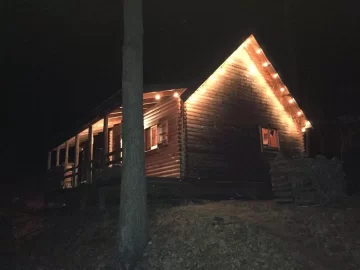

Any pics?
Any pics?
Sure, here's one...
[Hearth.com] Size (Thickness) of Firewood
Very nice. That's a pretty fancy way to stack cord wood. >>
