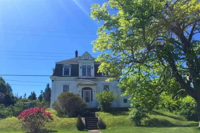

It is a centre hall plan with hallways up and down of just under 6 feet wide so plenty of space to move heat and I have a ceiling fan to install upstairs. Old photo before the windows updated.

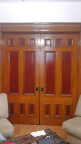

Post pics of the pocket doors !!!!!! :cool:;)

Great-looking house and pocket doors! Do you know anything about the sea captain?
A friend in CT has a sea captain out of Mystic, CT as an ancestor. I mentioned he should go to Mystic Seaport and ask the archivist help him learn about the captain.
I haven't much info on the captain, just that he was on a fishing boat so likely a schooner. I do have the family name so hope to learn more. Its important to know what kind of captain he was here as where I live was a major spot for smuggling rum during prohibition era and Al Capone is said to have visited the local hotel more than once during his heyday.
