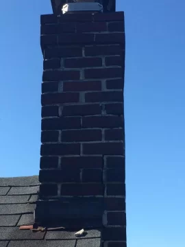

Hi everyone, my wife and I recently purchased a home now coming on two years ago... And like with any new house we started work on it from the inside out - Replaced the furnace (Ouch on the wallet), replaced the main sewer pipe running from the 2nd to 1st floor and a few other smaller things.
Now it's the chimney's turn. When we got the house we noticed there was the slightest lean away from the house, almost not noticeable at all. The lean is there, two years on but not significantly changed. What has changed however is the mortar between the bricks has come out and the flashing is massively damaged. Long story short, we had 6 different people come:
The 3 companies wanted to tear it all down and go down 12-14 courses of bricks. Where as the other 3 smaller companies gave options for both. We settled on one guy who wants to do it for $4,500 - Full rebuild and flashing. Or he would ground out the mortar, replace it, and do the flashing for $1,600.
We like the guy, but money is very tight for us. So we wanted to see if any of you have been through this before. I saw a post on here back in 2007 with the same general scenario but that chimney looked in far worse shape an ours lean wise. I will attach photos. Tell me what you guys know/think. Thank you!
PS: when we got the house inspected, he mentioned that the mortar just needed to be replaced, he felt the lean was not significant enough for a full rebuild. But that was 2 years ago.
[Hearth.com] Slightly leaning Chimney question [Hearth.com] Slightly leaning Chimney question [Hearth.com] Slightly leaning Chimney question [Hearth.com] Slightly leaning Chimney question [Hearth.com] Slightly leaning Chimney question [Hearth.com] Slightly leaning Chimney question [Hearth.com] Slightly leaning Chimney question [Hearth.com] Slightly leaning Chimney question [Hearth.com] Slightly leaning Chimney question
From the pics it is hard to say but it really looks like it just needs repointed and recrowned. Mayby a course or teo relaid. But without seeing and feeling it in person it is hard to say
Thanks for the reply bholler! We feel that is the direction we are going to go, but more reply's cant hurt. Have a good 4th!
It looks like the chimney cap has deteriorated to the point where water is getting into the mortar, freezing, and cracking the mortar. To me it looks like you could redo the chimney cap, re-point the mortar, and then put a sealer on top of the mortar chimney cap. Or put a metal cap over the top of the chimney. The main thing is to keep the water out of the mortar. I would also seal the mortar all the way down after it is re-pointed.
Is the chimney foundation sinking more on one side?
If money is an issue, type S mortar is $5 a bag at Home Depot. Flashing and flashing cement are also pretty cheap. Many good tutorials are freely available on all of the above if you have internet access.

You would also need to rent scaffolding. You would need a grinder and diamond blade. To me it looks like that brick should probably have type n at most used on it but again without being there to check the hardness i cant say for sure. Then it should have a poured crown not just a wash crown. And no sealer on any of it at all. Do the masonry right and dont rely on bandaid sealers

In any case thank you guys so much for your responses. The Chimney structure does not appear to be sinking really on either side when I was up there.
There is that small lean, but we are unsure if it because there is damaged brick/lack of mortar or something else.
The foundation seems totally fine - it looks like after around 14 courses from the top of the Chimney it starts to lean a little to the right or away from the house.
