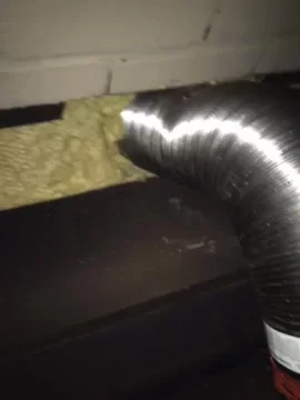

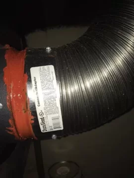

The other issue is the liner. Duraflex says that the liner is a ‘No Pierce” liner, but the installer used screws to connect it instead of clamps. I have the feeling he used the same method when he formed a union in the chimney. Also, they tried to squeeze a 6 inch liner through a 4 inch hole. I understand that ovalizing is okay, but crushing it to fit is nonsense. In picture you can see a clear dent in the liner. They also went right to the stove with the pipe, instead of a T connector, which I have seen used more often than not.

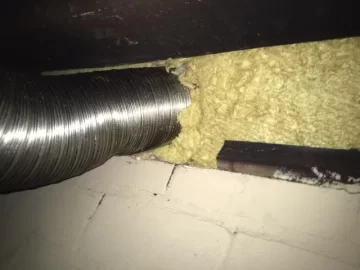

Furthermore, the stove came with a kit to seal the flu. The installer did not use it, just stuffed fire blanket material in there. I was told this too would fall out.
I am greatly concerned that the issue with the Duraflex liner are a potential problem and/or fire issue, and if the way they attached the pip is okay.

Welcome Rich. Yes, a clamp connector should be used for Duraflex. Why was there a union in the chimney? The picture didn't come through. Please post shots of all areas of concern. Have you contacted the owner of the company with your concerns?

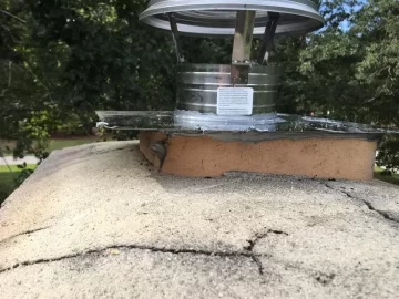

I should have added about the cap. Its just a flat piece of steel and you can see its not centered. It almost seems like its pinned in the corner.

If you are unsatisfied with the work then removal and reimbursement is an option. It does look like a bit of a rush job. No RTV should be on the flue exit collar. It is not rated for the high temps seen at this location and will stink badly when it gets hot. It needs to be removed. The installation looks down and dirty, like it was done by pellet stove installers.
Was this a low bid? Was a blockoff-plate and cleanout tee requested for the original quote?
Well I can see a few issues right off the bat. The liner should be insulated for safety and performance. There should be a tee so when stuff falls down the flue it has somewhere to go and does not block the flue. They should use band clamps instead of fasteners but at least use rivets with backing washers if need be. There should be no silicon on the liner anywhere but to seal the top. They should not have smashed the liner they should have cut the damper out. And there should be an insulated blockoff plate (but that is not a safety issue and really is not required)
I personally would have them uninstall it and refund the money for everything but the stove and delivery of it. I would then find a competent installer who will do a safe install the way you want.

Your chimney crown is also in need of attention, don't mean to beat ya while your down...

I looked at the pics again and they did cut the damper frame but there apparently still was not enough room all it would have taken was pulling one brick to get clearance.

Thanks for picking up on the crown, meant to mention that. It's unclear whether the splice was done with a coupler or not.

your chimney crown is also in need of attention
You might also need to replace that top clay liner tile when you do the crown. When crawdads have taken up residence inside the tile, it's not a good sign. ;lol
