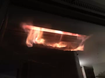

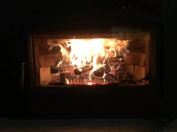

So, for an update: using spray air and a shop vac, I thoroughly cleaned the cat and it's night and day. Haven't been burning the last few days because of a variety of issues. Finally loaded the stove tonight with six small splits of various wood, all in the 12-16% range. Let it burn for about 10 minutes with the baffle open, closed the baffle and no slow down on the fire at all. Cat lit up instantly, and I could lower the air for rampant secondaries almost immediately. Just night and day I tell you, night and day. Lesson learned - keep a few cans of air on hand and clean that cat more often.
First image is with baffle open, second one taken right after I closed it.
