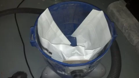

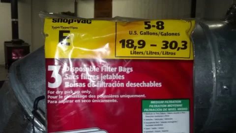

I vac fines. As for the bag, I suggest a FULL Drywall filter Bag. It goes on the inlet inside the shop vac.
A HEPA and one of these, will eliminate 99% of your problems
View attachment 87554 View attachment 87555
DexterDay That's exactly the same set up as I have.....drywall bag and Hepa filter! I will post a pic tonight with my current Hepa filter and a new one I got this evening. But I still will get small amount of gray dust in the room in front of the stove and black dust on the top of my fireplace mantle. I am bulk fed, so I carry a metal can that holds about 38 pounds of pellets which I pour into my hopper. I would love to know how you vac your fines.....and how the heck you clean your stove with the combustion fan going.......Bill

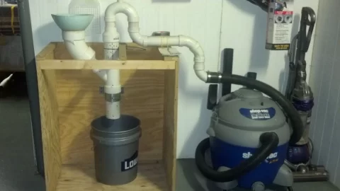

As for the fines, imacman posted a good link. Here is mine :)
[Hearth.com] Small amounts of gray to black ash being deposited in main heating area. .??
