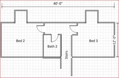

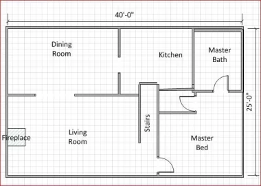

Can you post a sketch of the floorplan or describe the first floor plan? The insert will be an area heater. If the stove room is closed off by narrow doorways then it can be a challenge to make outlying rooms comfortable while not having the stove room bake.
Here is a rough sketch of the floor plan. I'm not at home so dimensions are not perfect, but should be within few feet. I envision some difficulty in the master bath and the upper bedrooms.

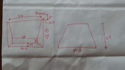

Also attached is the fireplace dimensions. The chimney is almost 25' with a 13"x18" clay liner, so I plan on ordering a 25' pre-insulated flexible liner.
It may take a little creative fan work or a ducted fan to move the heat to the kitchen and master bath, but possible. The upstairs maybe ok, especially if it is preferred to be a little cooler for better sleeping temps.
