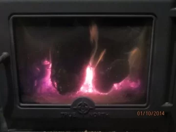

1.9 cu ft
overnite I still have coals in the AM, with red oak often 9PM ---->7AM

I immediately thought of the TN19 also.:cool:
FYI: Made by Pacific Energy
Look for stoves with squarish fireboxed like the PE True North TN19 or Super 27, Napoleon 1400 or 1450, Jotul F45 or F118CB(box stove), Enviro Kodiak 1700 and the Lopi Endeavor.

The TN is priced lower, and is a little different. I know it has secondary tubes, instead of the baffle that most other PE stoves use. What is the verdict on the True North, anyway? Is it still available?
Yes the TN19 is still sold and available. There's one sitting on the floor at our local True Value.
Still absent from PE's site. I saw one at a local dealer a few weeks ago, too. Didn't think to ask about it.
And it will be, this is a decision by PE's marketing dept. Not every one at PE seems to agree with it, but that's the way it is for now.

I understand the messy part in general but the 13 is ridiculous. If any coals or ash are anywhere near the door they fall out when you open it. After looking at the True North, I think I'm interested. Priced locally at my hometown dealer for $950 with the pedestal, which I like. Nearly the same size firebox as the 13 I currently have but the front to back load I'm wanting. I really like the 30-NC too but I'm afraid that it's just too big for my 1700sf house. $1000 is my budget and so many stoves are just way too far over that. I don't want some cheap pos either.
I live in Western Oregon so we don't really have the super cold weather that some here get. I can get an all night burn out of my 13 even using doug fir and alder so I think the True North would be perfect.

I'm bringing this back up again because I want to know about the 30NC. Would it be to big for my 1700sf house? Is it going to be too much heat? I really thought I liked the True North TN19 until I looked at one in a shop the other day. The TN looks a little "cheap" to me. The air adjustment lever was so flimsy and the door hinges were really small looking. I really like the construction on my 13NC so I assume the 30 is similarly built.
I also like the looks of the Timberwolf 2200 model but haven't seen one in person so I don't know for sure. As you can see money is an issue so I understand that I'm looking at low end stoves but I guess I'm just comparing them to Englanders which seem to be pretty dang good stoves.
