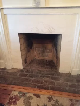

hello! I have a 1100 sq ft home from the 1800s in Central VA. We are planning to install a wood stove as at least supplementary heat in the winter. I'm having trouble finding the right stove for at most $1000 if possible. My fire box opening is 31 in x 30in (H x W) and 18W at the back. It is 19 in in depth. The brick in front goes about 18in in front of the firebox. I'm worries about clearance with the small firebox.
Right now the HiFi Shetland 905 is my favorite but I'd love suggestions!
  • [Hearth.com] Small Wood Stove Help

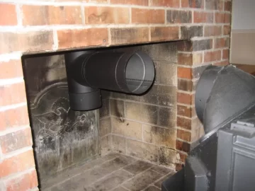

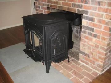

If I owned a house from the 1800's with a small fireplace opening such as in the photo I would be looking at this type of installation to obtain every possible BTU I could to heat the inside of my house and have a good view of a beautiful burning fire.

Assuming that the face surrounding the fireplace opening is completely non-combustible that would make the mantel clearances the most important thing to take note of. The mantel looks very basic so removing it is an option to consider. It could be replaced by a non-combustible one or just left out. For an inexpensive small stove I suggest you consider the Englander 13NC or 13NCi (insert) The are sold at HomeDepot and at Lowes under the Summer's Heat brand (same stove). That's a very affordable stove that is decently constructed.
Be sure to budget for an insulated liner in the old chimney.
