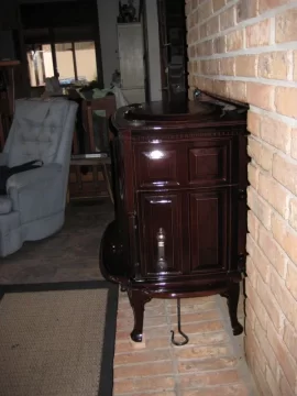

Last February I did a similar installation with a Jotul F600 woodstove. The new stove sits in front of my fireplace opening with a small portion of the rear protrusion of the stove inserted into the fireplace. As begreen mentioned, I installed a block off plate and also laid some insulation on top of it for good measure. The stove throws great heat out into the room and I did not see any need for a blower unit. I did a little experimenting with a couple different small fans placed inside the fireplace opening and did not notice any appreciable heat beyond what the stove was radiating on its own. If you go with the Oslo I feel certain you won't loose any heat due to a tiny portion of the rear of the stove sticking inside your fireplace.

Thanks for the pics. I see your stove comes right up to the edge of the brick. But you also have a raised hearth. I don't, mine is almost flush with the hardwood floor.
I also see you are using a hearth rug to get your 16" of ember protection. Is that tile underneath the hearth rug? Could a hearthrug get me a few extra inches of SAFE protection for my hardwood if I wanted to sneak the stove out a few more inches?
Does the Jotul need heat protection in the front of the stove more than the 8" recommended for the sides? Is the 16" recommendation just for ember protection or is there a heat protection component to that 16" requirement?

The Jotul F600 calls for 18" of right side clearance where the loading door is located and 18" in the front where you can also open the doors for loading. On my set up I have about six feet of hearth to the right where I do all my loading and just the hearth rug out front. However, I only open the front doors when the stove is cold to clean the glass, never to load wood with a fire going. As you noted, I have a hearth rug in front of the stove for ember protection. The floor beneath the rug is a laminate tile. I've considered removing a few tiles and replacing them with ceramic tile, but since the front doors are never opened while burning it's more of a code consideration than an actual safety issue. If I ever sell the house I'll be sure to have everything up to code. As for your situation, if you are going to be loading your stove through your front doors then you will definitely need to follow the manufacturers requirements for combustible clearances out front.
