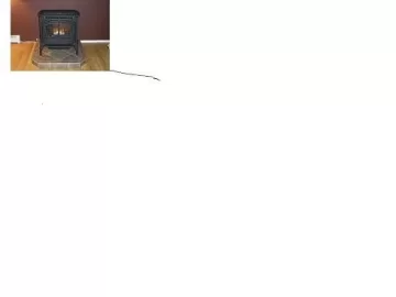

Smelling smoke from my enviro m55 cast
heres some pics

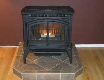

hey I just sent a pic but was just messing around didn't think it would go through. I work on getting better ones
new pics hope it works

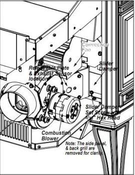

I found this picture in the technical manual and I can see the area that you're referring to. If my problem is the same one you were having it looks like it could be an easy fix.
The installer is scheduled to come take a look at the issue on Friday but I'm hoping to resolve the it myself before then.

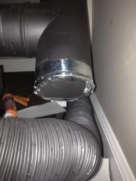

So the leak ended up being worse than I originally thought. I realized that the T was leaking from the bottom (underneath) which I didn't even think was possible. It's all taped up now but looks awful as you can see from the attached pic.
Fired the stove back up but could still smell smoke so I went leak hunting again. Sure enough, the adapter was leaking too. Now that's all taped up and I let it burn all night. When I woke up the smoke scent was minimal but it still is there.
I'm really getting frustrated with all of this and the installer is coming back on Friday. At this point, there's just no way I'm going to be satisfied until I smell no smoke at all. I've got a 6 month old son in the house and I feel awful every time I wake up and smell smoke.
