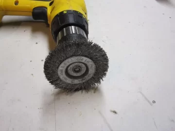

Also, use a 3" wire brush wheel for cleaning the burn pot. Get the one that has the stiffest wire bristles. You will be amazed at how quickly and easily this works to clean out the burn pot. Yes, you will have to scrape some of the carbon, but this gets about 95% of the junk out.

That's cheating! ;-) But a good tip, I have an air powered Die Grinder. That and the wire brush do a nice job on getting the buggers out of the liner. Another tip for the others: Once a season I take my(liner, fire grate and burnpot) over to a buds hose and use his sand blaster on them. Both sure beat the scraper/chisel routine. That and some hi temp black paint(not the liner though) make them like new for the summer layover.
