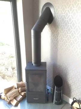

Would you post a photo of the current setup.
I have single wall 90 degree ell connected to single wall stovepipe leading into a tee connected to my flue. I have had those small puff backs in my stove before and never had smoke leaks from any of the stove pipe joints. I have just 3 screws in each joint and no sealant.

thanks
  • [Hearth.com] Smoke billowing from everywhere

Here’s an example of many
That's terrible. So far it sounds like you and the installer have done everything right. Are you always seeing flame on the wood in the firebox?
We don't have this stove here but it looks like a very simple burner with just a baffle. This leads me to think the wood is smoldering?
The only thing I can think of is a possible air leak in that bottom section of stove pipe. Perhaps try a stick of incense with no fire in the stove and go around that stove pipe to see if the smoke from the incense is drawn into the stove pipe.
You should have a constant draft if the air vent is open with door closed. An air leak above the stove would weaken the draft from the air vents in the stove.
