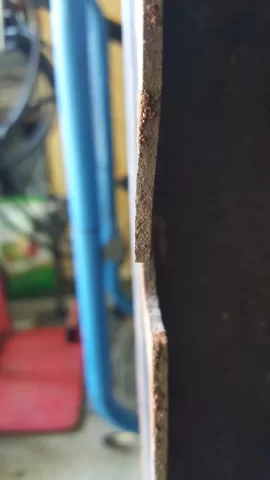

Hi ,this is a side view of where the door latch closes is supposed to be ofset like that or is like that from years of use?

Interesting. Harman didn’t get big in our area till the P61a. I’ve seen a manual pc45 but it was brought in from out of state.

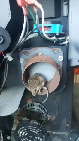

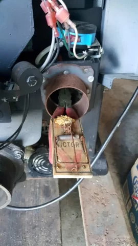

I was looking around back of stove while it cooled down noticed a mouse in the fresh air intake behind flapper trued to get it out but it disappeared, took the shop vac and sucked out that spot at that piint I set a trap outside the intake will check trap tonight.

That was my trap but when I got home from work trap was empty. Grabbed shop vac popped open the flapper it came out in that condition
