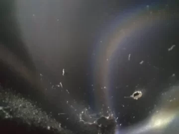

when we shut off the stove it does its normal shutdown, blower stays on for about 15-20 minutes or so...
But when it turns off in about 5-10 minutes after we smell smoke in house...Today i noticed that under the stove theres 2 little holes in the front corners that the smoke it coming out..
we clean the chamber pot and surroundings after each burn, even in the 2 little chambers inside ...
We have a King Ashley 5500M
any help would be really appreciated ...
Stan
Can you show a picture of the holes and locations. Firebox should be a sealed unit.
Front corners underneath
  • [Hearth.com] smoke in house when cool down
I would seal them up with hight temp rtv. I have read that ppl have sealed them so im assuming it is a common acurance wth the 5500m
