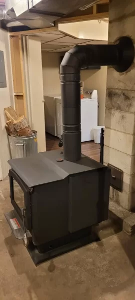

I had this England's Stove Works 32-NC installed two years ago. I probably should have done more research about it, and how the install would go, etc, before doing it, but so be it. There's a stainless liner in the masonry chimney, and it's about 20' long, the chimney has a cap about 3' above the roof ridgeline, the black pipe is double wall, this was a professional installation and it was WETT inspected.
[Hearth.com] Smoke leakage, and other questions
My problem is that occasionally it likes to leak smoke from the black double wall pipe, particularly on the horizontal run. Some of this I learned to deal with by general experience, some still leaves me perplexed. In general it would like to do this on start up or reloads if you leave the door open or cracked. The solution was to not leave the door open for very long. Also if the chimney started to experience too much buildup it would do this more, so cleaning it would help. However it's done it just when running the stove with the damper full open (door closed) trying to get it up to temperature, in which case if I damp it down I can stop it from leaking, but that isn't ideal.
Any ideas what I'm doing wrong? Or is there other factors at play? It drafts really well most of the time, sometimes I'm fighting the cold stack phenomena when lighting it, but I learned to use dry pine kindling and a propane torch.

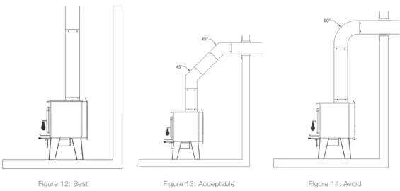

It would help replacing the 90 deg elbow with two 45 degs.

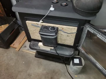

Then preheat with a heater. Make a plywood template for the door and use a small cheap space heater ....The torch is too slow. Try burning kindlin first for 10 minutes or so then add the logs and see if same results.

Is it a basement install?
Yes, in my mechanical room. Which is a plus and minus. The main reason I put it there was the masonry chimney was already in place. But it does a decent job of heating the basement and the upstairs through convection. I've wondered about trying to make it distribute heat better, but that might be another topic.

Preheating it with a space heater seems, umm, like a pain. I could try starting much smaller fires first. Sometimes it works fine, sometimes it doesn't though. I build all my fires top down, I learned it just didn't work building them the "normal" way in my first season. I don't have a thermometer in the pipe, I just go by the one on the top of the stove to give me an idea of how hot the gases must be. I have an IR temp gun, but of course that doesn't work on double wall pipe. So I guess a flu probe might be worthwhile, but I don't really want to spend a bunch of money on something if it doesn't provide me with useful data.

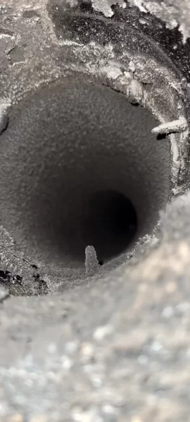

Also, on chimney buildup...
This is what it looked like before I cleaned it last time (2 days ago). It's a cell phone picture taken by sticking my hand in the masonry stack and pointing it up the liner.
Was this in any way at the point it needed to be cleaned? I only cleaned it because I had so much smoke leakage the day before, which was what prompted me to join and post. Granted you can't see up to the top, but would it be much worse up higher as the gases cool?

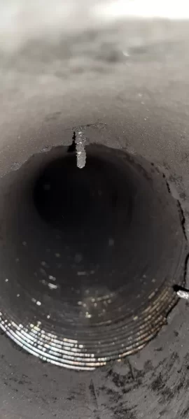

This is after cleaning:
Is this adequate cleaning?

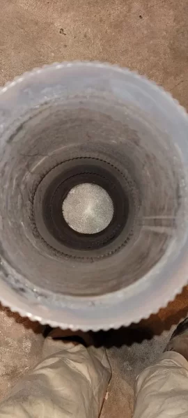

The black double wall pipe looked like this after cleaning:
No before picture, but there was only maybe a 1/4" of fuzzy stuff around the outside.

In your situation you must preheat...so it's a hairdryer for 10 minutes (try with empty no ash stove), draft collar (expensive and costs on electricity), candle for a long time etc or 5 minutes with a heater with plywood face and shelf (best way so no ash blowback).... and then zero smoke on startup...put good kindlin in and small pieces of dry ready to burn wood. Use a firestarter.

If the stove can move back would that potentially help my issues? I thought it was annoying and stupid they moved it out as far as they did, but I wasn't sure if it had to be done or if they just did it because that was the length of pipe they had on hand.
Shortening up the horizontal will help a bit, but there will still be the two 90º turns which slows down the draft. That said, there's no harm in trying and it if helps, no cost.
