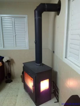

(2) 90 deg bends can be causing your loss of draft, perhaps changing out (1) 90deg bend on the inside of the home to (2) 45deg will reducing the smoke tumbling and provide the needed draft correction.
Hi, Even if the 90deg bend look like this photo? for me it looks like a small 45deg.

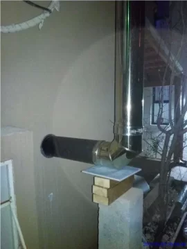

Is it possible to modify your installation to have a flue setup something similar to this, being less restrictive it could help reduce the backpuffing of smoke back in to your home. Keeping the flue and chimney above 400°F will also help.
[Hearth.com] Smoke leaks from the stove
That will be impossible, this installation makes the stove too far away for the wall, it will take to much place, and will be uncomfortable to us.
Thanks for the idea.
Ihab
